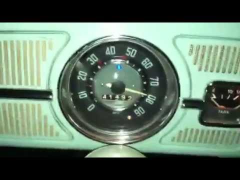

                      Ta ai um video que eu achei interessante para "ilustrar" o tópico
                      1964 VW Bug, 1679cc engine, DPR counterweighted crank, FK-41 cam on 112LC, .035 deck, 9.6:1 CR, dual 36mm Dellorto DRLA carbs, stock dual port heads- no port work, 1.4 rockers. Has stock trans with 4.37 R&P and 205/70-15 tires. I haven't had a chance to take it to the track yet to see what it runs in the 1/8 mile.
